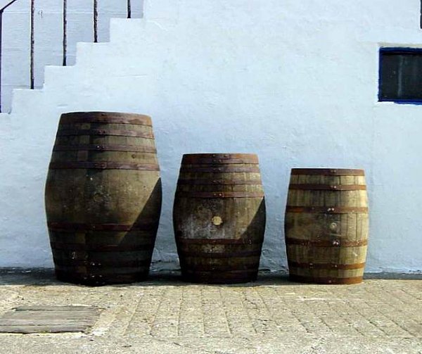

Hogshead:
A 250 Litre cask. This is the ideal and most common size of cask in which to mature Scotch
Whisky. Barrels imported from the US are usually rebuilt as hogsheads.
http://thewhiskydvd.com/whisky_glossary.php
Butt Hogshead Barrel
